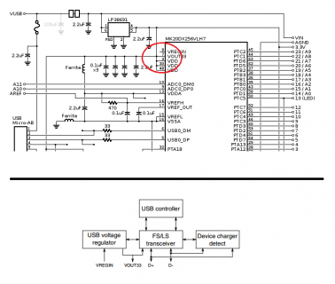

The MKL02 is smaller than the 4x4mm version of the MiniTAN54, allows the retrofit of the external voltage regulator on the Teensy 3.x series boards.
Yes, the reduction from 16 to 9 square mm helped a lot. So did the change from 0.4 to 0.5 mm pitch. That and other improvements in the manufacturing process offset the cost of the new voltage regulator.
