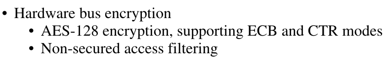

I don't think it can decrypt single bytes.. and it has to work on small blocks instead? Perhaps a 32Byte block -that would fit the size of a cache line. Paul?
I need to be careful, because pretty much all the documentation is in NXP's secret security manual. PJRC signed a NDA with NXP, so I really can't talk about this sort of info.
But I can point to page 177 in the public reference manual (rev 2, 12/2019), specifically this:
AES cipher always operates on 16 byte blocks (even if the key size is larger).
We're not using ECB mode, except in the test which runs as part of the fuse write sketch. The EHEX file definitely does not use ECB mode.
