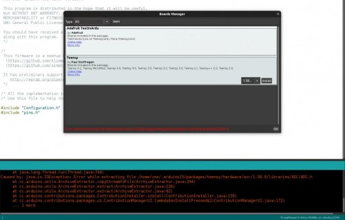

Error installing using Arduino IDE (1.8.19)
Tried a few times same error.
For IDE 1.8.19 the TeensyInstaller.exe of TeensyDuino is required.
Board Manager support was added for IDE 2.
For TD 1.58 see downloads link on PJRC.com - found in the announcements forum on release
For TD 1.59 beta #2 current (for today at least) in Announcement for that release
To explain further (now that I have a little more time to write a better message), Arduino 1.8.19 Boards Manager can't be used, for a few good reasons beyond this simple error.
1: 1.8.19 lacks pluggable monitor. The installer adds a Teensy-specific monitor, so the non-Serial USB Type options can work.
2: 1.8.19 has old pluggable discovery, Teensy package supports only pluggable discovery 1.0. Starting around 1.8.15 or 1.8.16, an earlier version of pluggable discovery was added, inspired by the Teensy-specific discover the installers added to the older IDEs. But pre-2.0.0 pluggable discovery used a different protocol. The Boards Manager package files have a new pluggable discovery tool which doesn't support the old version which Arduino never documented (other than of course publishing the Java source code).
3: Java serial monitor is far too slow. On Windows the whole IDE crashes if Teensy 4 runs a simple program which prints at maximum speed. The installer adds a huge patch to allow the serial monitor to keep up (more or less, imperfect as data loss can occur, but it keeps the IDE from running out of memory and crashing).

- and in the main Arduino2.0 window, opened the Boards Manager by clicking the left-side board icon;
But the search for "teensy" gives no result... hence impossible to and click "Install".
Sorry, you said that you had downloaded Teensduino.exe. You don't need that for Arduino 2.
I am still on Arduino 1.18, with VisualMicro, so I will be unable to help further, not having experienced Arduino 2.
Sorry.
