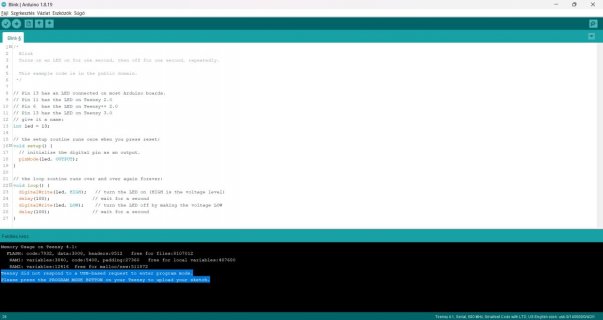

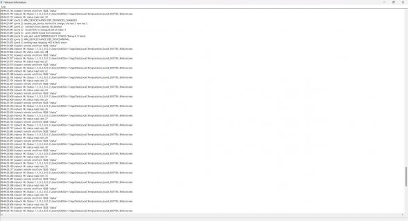

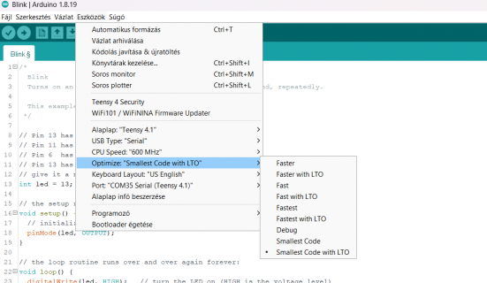

Thank you very much for the information. Now, just to be sure, I downloaded the TeensyDuino 1.59 beta2 code installer for Arduino IDE 1.8.x. I installed it.
I set the "Smalles Code with LTO" option. I chose a simple blink code from the example library.
I uploaded it after compile. That worked. After that, I change the delay from 1000ms to 100ms to see if the update was working or not.
After pressing upload, Teensy started again and I got a timeout while uploading.
Got this error:
Teensy did not respond to a USB-based request to enter program mode.
Please note thtat there was no problem with platformio, not with the normal case.
I have a problem when I try Lockable verision. Or Teensy is locked with the key. I admit, it could have been a problem if I copied/updated something wrong under PlatformIO. That's why I made it, a simpler, reproducible code, and tried with Arduino as well.
I attached some photos.
Should I attach anything else to this information? Please let me know and I'll try to help to better show the problem/error I'm experiencing.

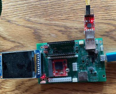

Here is an attempt to fix the zero baud rate issue reported in msg #73.
If I run this and use the COM29 under Teensy ports on either IDE1 or 2,
This prints out as 0's for the baud.
For Arduino IDE 1.8.19, put teensy_serialmon.exe into C:\Program Files (x86)\Arduino\hardware\tools
For Arduino IDE 2.1.0, put teensy-monitor.exe into {AppData}\Local\Arduino15\packages\teensy\tools\teensy-monitor\1.58.0
