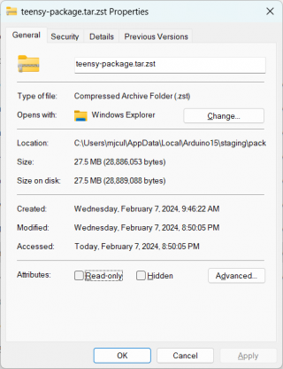

Paul:
I can get the "Unexpected EOF" to happen quite regularly.
Here's how it's happening for me:
0) Arduino IDE 2.3.0 on Windows 11pro, with TD 1.58.1 installed (also have separately installed Arduino IDE 1.8.19 + TD 1.59b6)
1) Open Boards Manager & select 0.59.6 (shows TD 1.58.1 as current), then click INSTALL (picture #1)
2) Installation fails with "Unexpected EOF" (picture #2)
And, here's the file info as requested:
Anything else that I can provide that might also be helpful ??
Mark J Culross
KD5RXT
Looks like your teensy-package.tar.zst file is definitely wrong. It's only 26,207,755 bytes.
The correct teensy-package.tar.zst file for 0.59.6 is 26,729,059 bytes.
None of the copies of teensy-package.tar.zst on the PJRC server are 26,207,755 bytes. Here are all teensy-package.tar.zst:
-rw-rw-r-- 1 paul paul 27335653 Mar 19 2023 td_156/teensy-package.tar.zst -rw-rw-r-- 1 paul paul 27364581 Mar 19 2023 td_157/teensy-package.tar.zst -rw-rw-r-- 1 paul paul 28886053 Apr 19 2023 td_158-1/teensy-package.tar.zst -rw-rw-r-- 1 paul paul 28886029 Mar 31 2023 td_158/teensy-package.tar.zst -rw-rw-r-- 1 paul paul 28688602 Aug 9 15:44 td_159-beta3/teensy-package.tar.zst -rw-rw-r-- 1 paul paul 26728904 Dec 2 11:28 td_159-beta4/teensy-package.tar.zst -rw-rw-r-- 1 paul paul 26720582 Jan 15 01:33 td_159-beta5-prelim/teensy-package.tar.zst -rw-rw-r-- 1 paul paul 26725149 Jan 17 15:51 td_159-beta5/teensy-package.tar.zst -rw-rw-r-- 1 paul paul 26729059 Feb 4 23:22 td_159-beta6/teensy-package.tar.zst
OK, as another test, I downloaded multiple times, each with the following resulting properties:
Install 0.59.6 over 1.58.1:
Result: Unexpected EOF
Result: SUCCESS !!
Install 1.58.1 over 0.59.6:
Result: Unexpected EOF (on 1.58.1 !!)
Result: SUCCESS !!
Result: SUCCESS !!
As you suspected/predicted, it now seems that this failure mechanism is very likely caused by an incomplete download.
