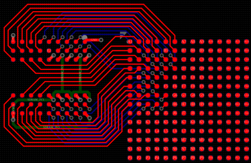

Thanks for all the people that worked on this to figure it out how to add sdram and creating libraries to work with it. I certainly would not have tried as it is beyond the scope of what i know how to do. So . . . I am starting to work on creating a custom board for a project of mine and wanted to use what was presented here as a basis for it. Unfortunately I am no master at routing and have no clue what I am doing. I didnt want to do a copy paste as I am using an mcu with a slightly larger footprint and doesnt align to this one (same mcu just different size as I already have a stock of them). shown below is a general trace layout of a 6 layer board between the 2 chips (left is sdram same as the one used in this thread and right is the imx). I have not added any additional circuitry or components yet as I wanna make sure the routes work for this before i go ahead and add em in. The idea is to use the sdram at the rated max of 166MHZ. bottom layer is the data lines and top layer is the address and control lines. i wasnt to sure about the length matching as i dont really understand how the timings work so generally followed this doc by issi (https://www.issi.com/WW/pdf/appnotes/dram/AN42S01.AN.pdf) which has general rules for layout of sdram. The only thing i am unsure about is the lengths. The difference between the longest and shortest lines is about 14mm for data lines and 10mm for address lines. In the guide they state a max difference of 20mm is needed. This would be on a more space constrained board so i needed the sdram to be as close to the mcu as possible (plus i just hear that it should be like that in general). also this does have a ground plane between the lines its just not active in the images. Idk what other information is needed but the connections are the same as in the dev boards, just routed to be closer. Maybe yall cant say with certaincy if it will or wont be fine but as a general is it ok to have that much difference between the longest and shortest path. Also forgot to mention the longest trace is 21mm if that has any bearing on this. Oh and what is the purpose of the zero ohm resistor on the clock line? Is it just to be able to swap resistors to get different impedences on the fly?
I basically copied the traces from the MIMXRT1060_EVK design files on the NXP site. I certainly can't tell if what you have will work, but here are some details from the kicad trace inspector for the GPIO_EMC_* traces in my design:

thanks for the reply. I had just looked into how to actually do the math for the timings and yeah . . . i am way off . . .
