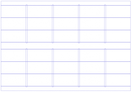

A manufacturing issue that has come up many times over Teensy's long history is rigidity of the PCB panel during pick and place assembly. We've tried many different panel designs over the years. The current design is working very well. For Teensy 4.0 the panel has 30 pieces arranged as 2 groups of 15. The long side of Teensy uses V-score and the short sides are defined by routed slots. The center of the panel (between the groups of 15) is a solid bar of unused PCB material, which keeps the slots relatively short spanning only 3 pieces. Quite a bit of fine tuning has gone into getting the PCB vendor to v-score at a shallow depth but consistent on both sides, so the panel remains strong and vibrates very little during pick and place, but also works nicely with the panel cutting machine which separates the panel into individual Teensy boards.
Castellated holes requires a completely different panel design. You can't use v-score. Usually tab routing is needed around the entire edge with only very small tabs connecting each piece to the panel. From a panel design point of view, it's pretty much the complete opposite of the panel design we have for Teensy. Done the simply and obvious way, it's a worst case nightmare scenario for panel rigidity during pick and place assembly!
I've talked with some of the other companies who do products with castellated holes. When I ask about manufacturing and panel vibration during pick and place, they suddenly clam up and want to change the subject. Apparently the Particle folks came up with some special way to control this problem, but they consider it secret sauce and won't say a word about it.
My point is manufacturing a product like Teensy or Arduino with consistently good quality isn't easy. Castellated holes or M.2-like form factor seem like relatively simple ideas. But the reality of manufacturing isn't so easy. There a lot of very difficult trade-offs to be made, and the path to making all those decisions is a long and painful journey of low yields and often times customers suffering if the problems manifest after final testing.
So a new form factor isn't completely out the question, but it's not something to be taken lightly. Especially with Teensy's software so in need of more attention, and with Sparkfun making progress on the MicroMod form factor, I'm really reluctant to go down a path where my time and attention gets sucked into manufacturing rather than software. I can tell you from a lot of painful experiences, when those problems come up they tend to suck all the oxygen from the room when it comes to getting any other development work done. Right now, I'm really not feeling much appetite for taking on that kind of risk.
