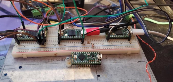

Hmm, in the pic below, the LC master was at center, I popped it out and put another T4.0 there to be as master.
At first I got like you, nothing much going on. But, as soon as I connected GND (between 3.3V and 5V pins) to each node (previously I used the one beside pin 0 (i left that still connected)), theres success?
Note: nothing was changed in current code that is also on github, no delays were added either...
In the end, it is just picky on connections.....
Video:
https://youtu.be/EtKpD7hbhSo
it's weird how 1 ground pin is different for functional operation, considering the usb grounds are also common off same PC. Seems picky to me :)
If i leave the GND beside pin 0 connected to them all, but disconnect the GND between 3.3V and 5V pin, the data stops transferring. When I reconnect that wire, it resumes...

i dont see a gnd wire for one next to pin 0 as well, tried swapping miso/mosi pins as well? in my setup i never changed anything when i swapped LC to T4.0, just added 2 jumper wires for GND between 3.3V and 5v.

That was the original configuration I tried without luck - the picture was after I was trying different connections. Also tried swapping pins without any luck.
Not sure what else to try. Running using the github version - you sure that the latest version?
EDIT: I did swap out one T4 with a T4.1 just in case but still no luck.

I did file comparisons with github and my files and they are identical, so it's definately connection issue somewhere
Also wanna point out, if I ONLY use the GND pin (between 3.3V and 5V pin) to FIRST slave ONLY, the 2nd slave works fine when receiving too.
If I disconnect that wire from first slave, both slaves stop receiving. So slave -> slave works but not T4 master without that wire, but master -> slave -> slave T3/LC work fine without that wire... I'm not a hardware guru so I cannot explain this phenomena :)
