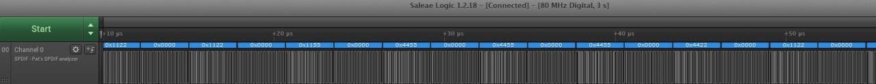

%&/ still struggeling with the SPDIF .. never seen that, only one channel works? funny, as it is pure digital over one single wire :)
Something must be terrible wrong with the data-channel.
One of my chinese SPDIF->analog converters outputs one channel, the other nothing.. :) Have to do more tests tomorrow, luckyly I can compare it with the software-version. Or both are problematic.. in this case I'd have to annoy my wife and use the home-cinema for tests... :)
@Kurt: Do you know if it is possible to decode SPDIF with Salae Logic 1.2.18? Have you ever seen a plugin for SPDIF?
Thanks! It is not that useful, becuase it decodes not more than the pure audio-data - and that even wrong because it is 24bit-data, not 16 bit. But at least it decodes *something* and that shows that I must have configured SPDIF wrong, or it has a DMA problem:
Even the lef-channel data is wrong: it should be 0x112233, 0x445566, 0x112233, 0x445566, ......
Edit: #1829: Yes :)
@Frank B - Sorry I missed the question about logic analyzer... But @defragster looks like he found one... Wonder how hard it would be to update to handle 16 bit data as well...
Been awhile since I worked on a plug in analyzer. I have one for Robotis Dynamixel Servos, which works reasonably well (does not crash too often ;) )
Glad you have it working!
yup, Tims find was useful :) Although the decoder is not good, it gave me a useful hint :)
