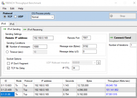

Somehow I got 101,141.952 on FBench with 1,000 packets of 4096! Though sketch reports more like:
Looped: 40566111 LoopedPoll: 1001 FNETMemFree: 162936 Link: 1
Megabytes: 4.096000 Seconds: 0.3410 KBits/Sec: 96093.8416
Looped: 39117939 LoopedPoll: 1001 FNETMemFree: 162936 Link: 1
So I believe everything is setup correctly, to my knowledge the receive frame uses an interrupt and then the stack just has to be polled every 1-100ms (the less the better). In my example I just have fnet_poll() being called from a separate thread, but if you don't need multithreading support you can just have it setup using any interrupt timer.

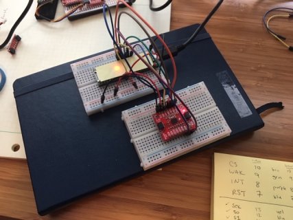

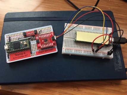

I'm doing simple regression testing with a dozen or so of my lab setups, just to make sure interfaces and all look good. I just tested the BNO080 IMU with the Sparkfun lib over I2C, all looks good to me. Here's and example of the PRY output, Exp 17 in the lib.
-0.7,1.3,-124.4
-0.7,1.3,-124.4
-0.7,1.3,-124.4
-0.7,1.3,-124.4
-0.7,1.3,-124.4
-0.7,1.3,-124.4
-0.7,1.3,-124.4
-0.7,1.3,-124.4
-0.7,1.3,-124.4
-0.7,1.3,-124.4
-0.7,1.3,-124.4
-0.7,1.3,-124.4
-0.7,1.3,-124.4

Completed next regression test, BNO080 on SPI. Looks fine, running Sparkfun BNO080 lib, sample quaternion output:
.01,-0.02,0.44,0.90,3.14,19.89Hz
0.01,-0.02,0.44,0.90,3.14,19.89Hz
0.01,-0.03,0.44,0.90,3.14,19.89Hz
-0.00,-0.03,0.44,0.90,3.14,19.89Hz
0.00,-0.03,0.44,0.90,3.14,19.90Hz
