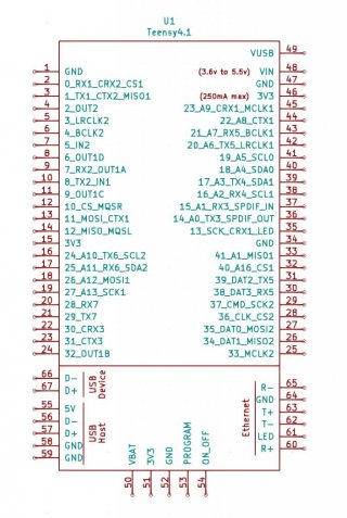

@blackketter - just added your T4 footprint and symbol to my kicad lib. Nice work.
Footprints pretty much match what I have on my breakout board for the T4.1 (just overlaid yours on the pads I put on the pcb. Couldn't do a match up of the ethernet connector. And didn't get a chance yet to check the symbol table.
Great, thanks!
One question: Is there value in putting locations for pogo pins to connect to the USB device pads in the KiCAD footprint?
@blackketter - Short answer from my view and how I use it - now. Don't know if others would share that point of view :)
I went ahead and added it. Here's what the symbol looks like:
