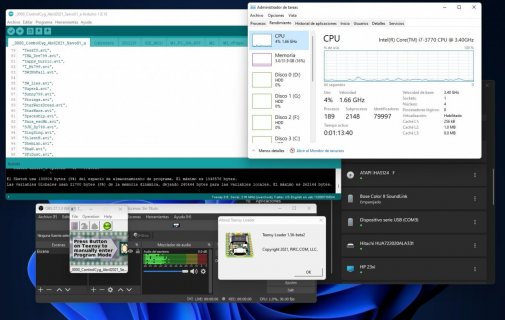

Installed and it runs ! Win 11 over old on IDE 1.8.16.

Third time: Teensy getting Programmed - this time a button push - and all Teensy I/O goes offline: USB and Button HID.
Plugged in a SFun Redboard and it chimmed in and then out multiple times no problem.
Even pushing button on T_4.1 got no PC response and no RED LED until computer ( win 11 ) restarted. Then all is well and normal for some time.
> Note the running Teensy's are mostly doing the SerialTest2 these days - so unceasing full speed Serial.print blocks - but it is UPLOAD that suddenly takes them ALL away.
Will watch for it again and see if I can gather more details. Did add test of Redboard - but it was on alternate HUB on diff PC USB port.
Exploring windows 11 on a computer that in theory should not support it ...
Teensy 3.6 online, IDE 1.8.16, teensyduino 1.56-beta2
