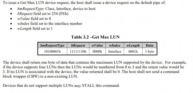

I found an issue with some USB Flash devices, and I'm not sure fix it. Apparently some devices with issue a STALL when you request getMaxLUN(). In that case we need to reset somehow, and I'm not entirely sure how that is to be done. Currently, if I request max LUN on that drive, the Teensy crashes, so for now I'm just skipping that request entirely.
This is something that I knew about and played with for quite a while. I never had an mass storage device available that had more than one logical unit number or would cause the device to stall. When you say it crashes do you mean that it hangs? Have you tried turning debug on to see where it crashes or hangs? It would be interesting to see what the debug output is.
There are a couple of things you can do to try and overcome the issue. In mscInit():
	msReset();
	// delay(500); // Not needed any more.
	maxLUN = msGetMaxLun();
//	msResult = msReportLUNs(&maxLUN);
//println("maxLUN = ");
//println(maxLUN);
//	delay(150);
	msResult = msStartStopUnit(1);
	msResult = WaitMediaReady();
	if(msResult)
		return msResult;
You can uncomment 'delay(500)' to see if that helps. I have seen some examples of this being used. Also uncomment the 150 ms delay after the call to get maxLuns. Lastly try commenting out 'msStartStopUnit(1)'. This also has been known to cause some devices to stall.
If you know where it is hanging, try adding a timeout and then issue another 'msReset()'.
Again, I do not have any devices available to me that exhibit this issue:)
@Paul - Does the EHCI driver automatically clear endpoint stall conditions? It's been a long time since I looked at this. It looks like halted pipes might be handled in 'followup_error()' function.
I'm pretty sure it does. The crash I was experiencing comes from a bug, which is fixed in the code below:

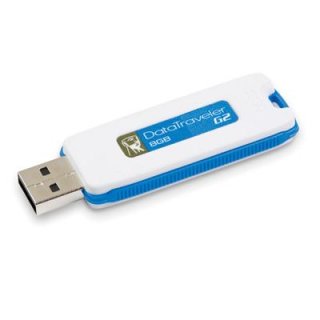

This one doesn't even initialize

Note: I looked up at amazon, and they have a few Kingston Datatraveler G2 drives, but none look like the one in picture. So not sure if they would be apple to apple...
And if they are all different not sure worth picking up any as may not reproduce the issue you have. Also if the ones that have issues are no longer available, then harder to get motivated...
Indeed it doesn't worth you time, very old unit, I'm testing with 1.57 Beta 3 and results are differents, I will try get somo logic in the errors.
