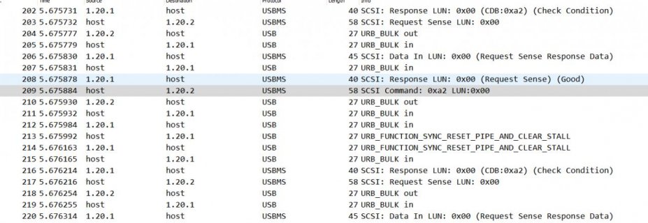

@mjs513 - I also noticed a couple of other things in those snapshots. Down a couple of lines you see "URB_FUNCTION_SYNC_RESET_PIPE_AND_CLEAR_STALL" twice. I think this is what we are seeing on the T4. For some reason the flash drive is stalling the pipe and that is why we are seeing the halted pipe and "ERROR followup". I know there is a way to rest and clear the stall. Just not sure how to do this with the T4.
Edit: There is also two "URB_BULK_IN" in a row after a "URB_BULK_OUT".

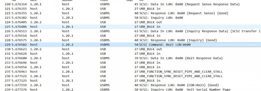

Think we had an issue with USB Pipe Stall before: https://forum.pjrc.com/threads/6813...ng-MTP-and-MSC?p=292596&viewfull=1#post292596 but I remember similar issues - just can't find them now.
@mjs513 @wwatson
@PaullStoffregen (if you are watching) - thread shows last look about a week ago.
Some of this lower level USB stuff is above my pay grade (of $0) ;)
Stalls - I have looked a little bit through the T3.6 and IMXRT manuals and trying to decipher some of the Jargons.
But my impression is that maybe to clear a stall there appears to be some Endpoint control registers
USB_nENDPOINTCTRLn on IMXRT and USBHS_EPCRn on T3.6 but I don't see anywhere in our code base that references these registers.
They are defined in imxrt.h...
Not sure if they would work or not. Might experiment later if we see the stall bit to try clearing it there/here and see if it does anything?
@KurtE @mjs513 - Here is a web article of interest with information on stalled USB 3.0 pipes and how to reset and clear them:
http://billauer.co.il/blog/2019/12/usb-bulk-overflow-halt-reset/
