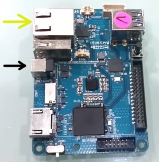

The Embedded article has a photo with a PCB having 1 chip visible (strangely in a 1990s-era QFP package rather than wafer scale BGA or other modern package normally used with today's advanced silicon processes) which appears to be sitting on top of an
Odroid XU4 single board computer. I recall the SiFive guys gave a demo at the
Teardown 2018 conference where a RISC-V processor they designed did not yet have working PCIE (or pretty much any other working I/O), so they connected its bus to some insanely expensive bus bridge which let it use PCIE peripherals on another motherboard-like SBC, which allowed their new chip to boot up Linux. Whether that's what Micro Magic is doing with the Odroid XU4 (which doesn't seem to make any sort of system bus available on those connectors) but how that Odroid board could possibly serve as peripherals or some other way to bootstrap their custom chip, I have no idea. At least in my mind, that photo raises a lot more questions than it answers. Maybe their chip was designed to be perfectly pin compatible with whatever chip Odroid had used, and they desoldered the original chip and soldered theirs in its place? (and the 1990-looking chip on the top just an analog chip making the current measurement?) And even though their chip supposedly uses so little power, they put Odroid's heatsink+fan back on? (that is Odroid's heatsink we can just barely see in the photo, right?) But if that demo really is their chip soldered to the Odroid PCB, how would Odroid's hardware provide the special 0.35 volt power their press release mentions? So many unanswerable questions...
